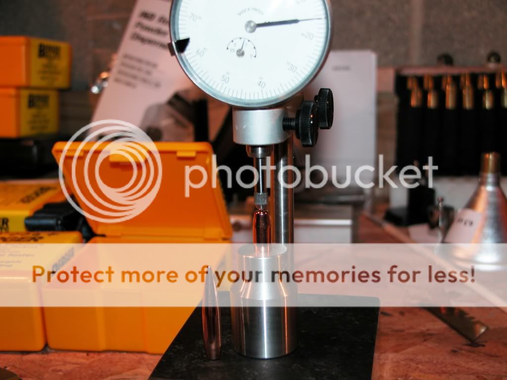

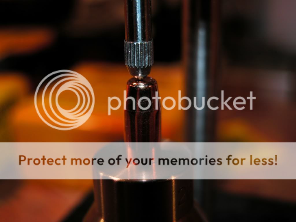

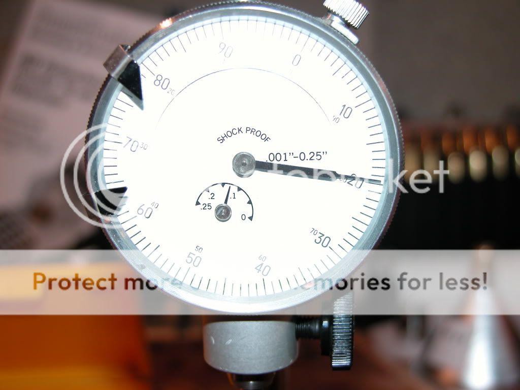

My tools:
- Sinclair 'nut' bullet comparator: http://www.sinclairintl.com/.aspx/pid=34262/Product/Sinclair-Hex-Style-Bullet-Comparators
It's simple, free floating, and I use it for all logged values. It's just one of those tools that happens to work.
- Wilson micrometer top inline seating dies, with an arbor press: http://www.sinclairintl.com/.aspx/pid=39884/Product/Wilson-Sinclair-Hand-Die-Kit-w-Micro-Top
This is actually a less expensive system w/resp to quality threaded seating dies.
Again simple, free floating, precise adjustment, & positive stopping.
- Caliper: http://www.sinclairintl.com/.aspx/pid=41332/Product/Starrett-6-Electronic-Caliper
A less expensive caliper to .0005 works fine for this.
- As far as qualifying ogive radius, I use Bob Green comparators: http://greensrifles.com/New_Products.html
I also use a purpose built taper mic w/software to determine actual ogive radius(for BC calcs). But Bob's comparator provides a quick check of many bullets.
I also use wilson bushing neck dies(some custom), and Sinclair expander mandrels, to produce ~1thou of neck tension with semi-cleaned(carbon remaining) unlubed necks. I do not anneal until it's actually needed. With this, I have low seating forces that do not create wedging of the seater plug against noses.

..I picked up a Sinclair Bullet Sorting Stand back in 2010,
[I already had the dial indicator] when they first came out several months ago....so far my "failure rate" is about 7 out of 100 bullets that have a greater than +/- 0.001" base to ogive dimension.
..I, too may be anal about my reloading...but at least I know when I miss it was either me or the WIND!!

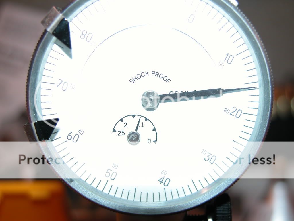

Here is the TYPICAL "pass" bullet:
Here is the TYPICAL "reject" bullet:
I don't see what you gain by sorting base to ogive. Neither of those two points are contact points. One is centered (hopefully) in barrel (ogive) not touching anything and the other is inside case, also not touching anything (bullet base).
6.5x61Super I don't know if you read through this thread, or others related. But if you did, you should suspect that your Buhay tool measurement is meaningless.
You're comparing combined variance in base length+/-bearing+/-ogive radius.
With this combination you can't determine if your measures matching actually mean the bullets match, nor if measured variance indicates a specific mis-match.
You don't know which is what as they aren't isolated measurements.
And can you determine the affects of each parameter individually & then combined?
That 4thou variance could be +5thou base length AND -7thou bearing AND +1/4cal in ogive radius,, all combining to mean nothing directly w/regard to seating depths, and internal/external ballistics.
It's tail chasing, and while it don't hurt to cull bullets as you're measuring, you're not gaining a thing in doing so.
