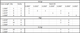

Follow up post!! First let me say thanks to everyone that chimed in, I appreciate your input. Now the good news, I think my hypothesis of not having enough powder was correct. As per the suggestion of a few in this thread I conducted an experiment with higher powder charges.
I pulled the bullets from the remaining rounds I had loaded with 38.5gr and then reloaded 15 with 40gr and 13 with 41.5 gr. One of my theories was that I was somehow losing powder between the drop and filling the case. So while pulling bullets I took the time to measure the powder in those cases. I found I was within ±0.02gr of 38.5 just as expected.
I fired the rounds over the weekend and found my ES and SD had seemingly not really improved. Then I started to look at the data a little closer and found it was really only one or two rounds that threw the data off. I suspect this could be due to reseating the bullets or just variability due to the condition of the brass from previous firings. If I excluded those few rounds the ES and SD improved dramatically. I then starter looking at the fired cases. I noticed that were was no soot on the cases as before. I also measured case base to shoulder length (using a comparator) and the neck OD of every case. This is where things got really interesting.
I found that the 22 rounds I had fired previously with 38.5gr varied in length from 1.5565" to 1.5580". I also noted that fewer of the longer cases had soot on them. When I measured the neck ODs I found they varied from 0.2905" all the way to 0.2955". The cases with larger neck ODs did not have soot. This clearly proved that my cases weren't expanding enough to seal when fired.
Next I measured the 15 rounds I had reloaded with 40gr. They varied in length from 1.5575" to 1.5580" with the majority being 1.5575". The case ODs were the really telling part as they only varied from 0.2945" to 0.2950". That's 0.004" larger than the smallest rounds fired with 38.5gr. The 13 rounds reloaded with 41.5gr showed the same pattern of longer lengths and larger neck ODs.
This all seems to suggest that 38.5gr of H4350 does not expand my cases enough to properly form a seal with the chamber. One could argue that simply pulling and reseating the bullets was what made the difference and not the low powder charge. I think however, the more logical answer is that the powder charge is not enough.
The reason it's not enough is also debatable. Is 38.5gr simply just not enough to expand brass in any condition? Is my chamber too big? Is my sizing die undersizing my brass in dimensions that aren't seen by my comparator? Is my brass too hard? Is it too hard because I'm over working it when sizing? Is it too hard because my annealing isn't working as intended? I intend to at least try to answer these questions before making any final conclusions. Most of them seem measurable without too much hassle. I'm trying my best to not let confirmation bias takeover but, it does certainly seem like it's just not enough powder.

Your method is valid to test your theory, and I think most all of us agree that you were loaded very low. Now don't forget to double check your die settings for the now properly formed brass.

I'm glad that you were able to solve the sooting issue. But I want to make an observation here that while you did an excellent job of testing and verifying your problem and solution, it was done at the expense of a large number of rounds when it was obvious from observation of your fired brass and low charge weight that it was the source of the problem. I can't say the rounds were wasted because you will obviously understand this going forward. But it was expensive.
You ask why isn't 38.5 gn enough to expand your brass. The question has a simple answer and that is you don't have enough pressure to expand the brass you are using to properly seal the chamber. It is common that starting charges listed in manuals will often not seal the chamber. That was not a consideration for the Load Manual when publishing the load. Most starting loads are based on case fill and some percentage of maximum load.
You are correct to say that chamber size will affect the pressure/powder charge needed to seal the chamber as well as brass hardness. Simple changing brands of brass could actually solve the problem. Concluding that either brass or chamber are the source of the problem is not indicative of a problem with either. Your expectation that the minimum load would be an effective load is where your problem lies. Assuming your brass variations are due to hardness would be possible but it is more reasonable to assume that the majority of the variation is likely due to variations in pressure due to ignition differences and bullet ejection issues as well as normal variations in pressure.
I wouldn't say the rounds for my experiment were wasted. 22 of them were shot at a local F class match where I took second overall. The remaining 28 were shot for fun which is what I do with this rifle 90% of the time anyway. Between the $40 I won at the match and enjoyment I get from just shooting, I don't see any of it as a loss or waste. It was just a lesson learned and experience gained.
I wasn't aware that starting charges often don't produce enough pressure to seal the chamber. I've only read a couple reloading manuals and neither of them mention that. Much more of the text is spent discussing the opposite end of the spectrum where pressures are too high. Rightly so given the danger that exist with overpressure rounds. In any case, it's helpful to know that starting loads often don't create enough pressure. I had suspected I didn't have enough pressure based on reading the forum posts of others with soot issues but, I didn't expect that a starting load wasn't enough. My experiment allowed me to see it first hand which is often the best way to get things past my thick skull lol
