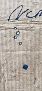

Here’s 5 shots with the Norma match 22 at 100 yards out of my 1710. Little under an inch. Some bigger groups thou of course but all in all pretty good ammo.
Thats fine. .my best so far is .72in 5x group out of my Annie with t22....and I could probably shoot another one every 50 tries. But it is not compet ammo cause they need to score on 10 shots, I think? Tac22 is the best affordable minute of squirrel ammo on the market for my rifle and probably yours too!
