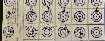

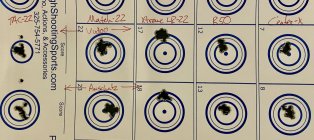

Todays testing. Grabbed the wrong rifle case so no Sako Quad results.
Conditions were very good, barely any wind. 10 shots groups at 50y and 100y. The TAC-22 each had a high cold bore shot.
Norma Xtreme LR did not stand out, but it was obvious every shot was supersonic today, 45F and humid. In warmer air maybe it will calm down a bit.
The Lapua LR stayed subsonic.
nice comparison , especially 10 shot groups , which vudoo which anschutz
