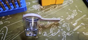

Hey Guys, happy Thanksgiving! Does anyone make a cup (with similar dimensions as the one that comes with the FX120i) that the kernels don't bounce out of.
I know Varget resembles Flubber on a bad day. However in the age of 3D printers and "soft" plastics something has to be available.
No?
Thanks!!@
Tall shot glass.
6 of one, half dozen of another vs the original cup.
On my setup the cup barely fits under the drop tube. So it's not the height of the cup.
I think a cup made from a softer material might be the answer.
Takes some really bouncie stuff to get out of a container dropped as described .
Maybe it has some help?
Take a few grains and drop them on a grounded plate. High high do they bounce.

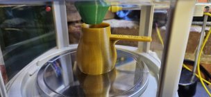

Ok guys found a solution to my problem.
I found a STL file for a cup. The bottom isn't flat. Rather it's convex almost to a point. With a little scaling it fits perfectly under my drop tube.
50 drops and not 1 kernal bounce out!

I'll stick with the gold one I printed. It's working flawless so far.

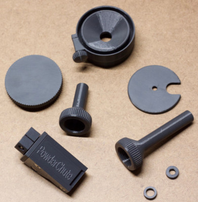

Do you have the actual STL file for this or a link to it?
I'll try to post a link below..
Let me know what you think after you print/use it.
