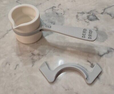

I think Ingenuity Precision may have the ultimate fix for when the stray kernel with his smaller platen for the A&D scale.

Others have mentioned Ingenuity's cup and I will get one eventually when my long wait for their system is finally done and my order is delivered. In the mean time this works just fine and I do like the turned metal cup that Area 419 makes... Just wish Ingenuity would make theirs out of metal such as a casting or even a CNC cut piece. I'd pay the extra cost... Just not a fan of printed plastic... or the static problems. {:~/
As for the smaller platen I have that with the A-419 triangular platen and it is not the fact that a granule may be laying on the platen {this happens rarely} and skewing the weight, but just the often as many as 10-15 or more bits laying around the outside of the platen at the end of a loading session.

Ingenuity precisions cup is a soft bottom and you don’t have that problem. It’s worth a look into.
