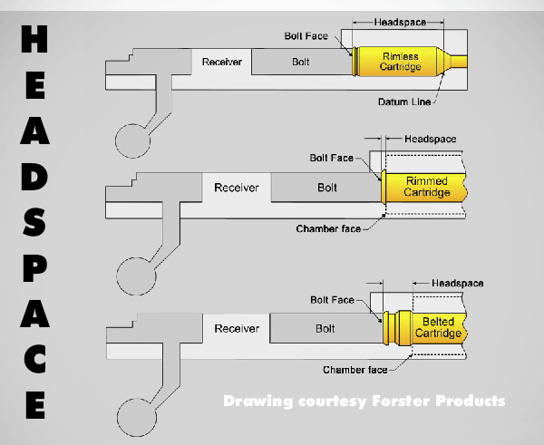

So based on your theory, a rifle set with a headspace of .050" and one set with a headspace of .043" are going to engrave the same? (Yes, I realize those are extreme examples, but that's the point isn't it?)
Headspace in 22RF is the most finicky change in accuracy you can get. .043" might shoot horrible in your rifle, take .001" shim out and adjust to .042" and it might shoot dimes. OAL, engraving, etc will always have affects on accuracy in 22RF.
EXACTLY what Carson Lilja told me - shim for accuracy.
This rifle, with the target pictured above , gives me all I need to see that he knows what hes talking about. I actually sent my action to him to shim and install barrel… seems like an easy enough thing to do but I wanted him to do it. And it shoots under 0.3"

"Shimming" pushes the entire barrel further away from the bolt face. It moves the bearing surface on which the rim seats further away from the bolt face, and increases headspace. In a 22 rf barrel set up with shims, and not glued / threaded in a more permanent fashion, the shims are placed in the receiver, between it and the barrel, and increase headspace, and are a primary way of tuning a rifle for a particular ammo.
You ever shot a .22 lr with 0.050 headspace? I find it hard to believe a headspace of 0.043 on a good quality barrel would shoot bad, unless the chamber was done incorrectly are you speaking from experience?

I am not taking it personal, but rather trying to understand his reasoning. and trying to figure how you deepen or shorten the chamber which controls how much bullet engraving occurs, with headspace. you do understand , if you increase headspace you will affect firing pin strike depth also which has an effect on ignition and has a great effect on how a rifle will shoot.
I am currently working on a Falcon action with zero head space, using proven donor barrels. I have to use shims to get the 0.043 head space I am after. now what I am confused about is how is it going to change the depth of the chamber? going by this Carson fella's use of shims
see this reamer spec. chamber depth is 0.600, how can spacing away from the breech face increase or decrease the pre-bored depth.

I can't tell you why head space makes a difference. But I can tell you that it does. I had head spaced my own Lilja barrel on a previous CZ455 & it shot nothing like this .... when Carson set this CZ457 action up.. It flat shoots.
I am not being snarky when I say you'll need to call and talk to Carson to get a better explanation. But Im happy with it.
Btw... There is no such thing as 0 head space. Look at the diagram. You have to have some head space in order for the rim of the Round to fit between the chamber and the bolt face.
You at least have to have enough head space for the thickness of rim of the cartridge.
Given that rim thickness is going to vary even in the best of ammo ... you're always going to have a little bit of free play in there as well.
I suspect that is what Carson meant when he talked about adding head space with spacers. The spacers used start at 0.0005.

1. There is no such thing as a "zero headspace" (your statement) gun anywhere in the known universe. Your statement suggests that you don't understand what headspace is.
2. Here's my best guess as to why adding spacers / headspace "tunes" accuracy in a CZ 455/457 (see disclaimers below)
Adding a 0.001 spacer to the CZ action increases headspace by 0.001" Thus, when the powder ignites, it pushes the case BACKWARD 0.001" as well as pushing the bullet forward prior to any "engraving." . This is how the CZ 455 / 457 accompishes what we know as "seating depth" in reloading centerfire ammo.... it increases "freebore" - the distance from the chambered unfired projectile to the "lands"

It is real easy to have zero head space when you are using donor barrels done for another action
It happens when the tenon length on the action is shorter than the barrel tenon length in other words barrel will screw in till it touches the bolt face
Get it now
