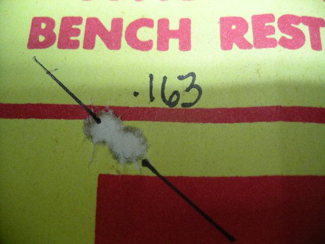

Urban's 6 BRA here with the .050 freebore, 8 Twist
70g Nosler ballistic tips
7 1/2 primer
30.6g of XBR 8208
Seated .010 off the lands
All loads are three shot groups
70g tnt, bullet seated .010 off the lands is shooting 3/8" horizontal groups, will tighten up as I adjust the seating depth, same powder charge as the 70g Nosler ballistic tips
The great surprise of the day:
75g V max seated .010 off the lands
7 1/2 primer
30.2g of XBR 8208
I am in love with that .050 freebore reamer! These barrels clean up easy, and I have 4 of them now, all shoot bug hole groups
Next time out will be the 87g V max in the .050 freebore, for giggles and grins
