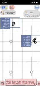

Thanks for the Shehane results. I’ve just ran out of the 180s and ran a few 184s to get a feel if I need to work a full reload work up. Just a little Bramley tuner action and they came right in. 44340ED5-E595-44D7-A862-A525ECC2070F.jpeg68C97541-C872-4CC3-A012-1C2BB9F4E92D.jpeg
Great Jerry ! Keep in mind guys. This is all about JERRY'S RIFLE . NOT YOURS. Please follow the HYBRID BULLET load development info posted previously to find what YOU RIFLE LIKES TO BE ITS MOST ACCURATE!!
