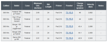

I have used 15.5 in a long throat 223 with 85.5gr Bergers. It got crunchy around 25.8grs and did not show pressure. I do not think you could fit enough to show pressure in a 223 case. This load was roughly 50 fps slower than 25.5gr Varget but also less pressure. Very Accurate. I need to test more.
Judging by Alliant's data,.. TS-15.5 is roughly 1 gr less than Varget or close to Varget. Closer to IMR 4064 amd AA-4064.
I would say from those numbers that it would appear that 1-2 gr more TS 15.5 would be required on a weight basis as compared to Varget. For example, I don't believe anyone would attempt to load 45.4 gr of Varget under a Juggernaut seated at 2.800 COL, or 44.1 gr Varget under a 200 Hybrid seated at 2.800 COL. Those would be unsafe and potentially dangerous loads. I'm not even sure you could actually get that much Varget into a case with those bullets seated at 2.800 COL.
The relative bulk density of a powder such TS 15.5 will play some factor in its use. Typical Varget loads used by F-TR shooters with 200s will often run at around 100% fill ratio, +/- perhaps 1-2% or so. If TS 15.5 really requires 1-2 gr greater charge weight than Varget to achieve a comparable velocity, that would suggest to me that it has a density (and shape) that will allow more powder to be put into the case as compared with something like Varget. Otherwise, one might run into compressed loads trying to achieve comparable velocity when having to use more TS 15.5 as compared to some other powder.

Was finally able to get my first shots down range from my new barrel this weekend. Just started gathering data. Initial results with the 200.20X and the 200 Hybrid indicate probable tune @ 2575 and 2566, respectively, from a 26" barrel with VARGET and Peterson SRP brass. Peterson SRP brass is averaging 55.7 grains capacity after first firing.
