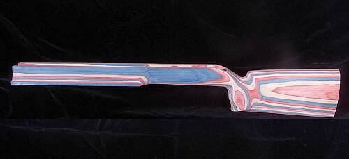

4. If you really want to get serious about bench work, you'll benefit enormously from a BR style stock with a wide, flat fore-end. The added stability really makes a difference. The Tooley MBR style is a good choice--you can both shoot it free-recoil or grip it if that style works better for you. Here's a laminated version made by Bruce Baer:
