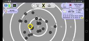

I shot my first f/tr in 308 this weekend. I used 2 different bullets to get a comparison of what my gun likes. I have the savage model 12 f/tr. I shot the new A-TIP 176gr hornady and the 175gr smk. The A-TIP shot at an average of 1925 fps @ 500 yrs and the smk was 1825 fps average. Both had same powder charge. The A-TIP had an average SD of 8.6 an the smk was 12 6. The smk had the better water line but the A-TIP had the smallest group. So my question is which one do I need to work with to get the consistency of more Xs. I did have 11 X with the smk and 7 X with the A-TIP. Attached in first pic is the A-TIP, the 2nd is the smk. I'm currently stuck on which one to develop for the gun I have an which the will perform consistently. Any advice would be greatly appreciated. THANKS

My 1:12 twist barrel doesn't like the 185 jug. I have worked both loads up to the tightest group of 3 rounds almost in the same hole. I know gun handling has play in my grouping skills so back to the question of do I chase the tighter grouping of the A-TIP or the good water line of the smk
I would do neither. I'd stop any load dev with those two bullets and put the money you saved into a 1:10 twist Krieger/Bart etc. and get it throated for the 20X with a .170fb+ reamer...because that's what you'll be shooting against.

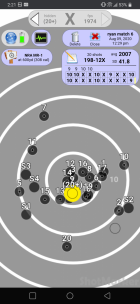

Don't think anyone mentioned it, but the sierra 155 Palma is also a great bullet. I get ~3020 fps with ~10 SD with thrown charges of 8208 xbr in my Palma rifle. All of these targets were shot at 600 with a sling and the first two were with iron sights.
