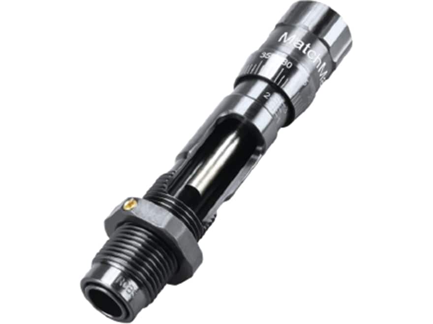

Get a seater die with a window and sleeve, like the RCBS Matchmaster. Super easy to load flat base and 17-22 cal bullets etc, just drop the bullet into the window and pull the press handle.
Thanks for this info. I have mostly rcbs dies, but I have all redding micrometer seaters for my bottlenecks right now. This could be a good permanent addition for flat base 223... and probably everything else too.
I typed in the RCBS Matchmaster Super and couldn't find it till I finally realized there was a period before Super. lol
This one I found on Midway is the Matchmaster Competition. Is this the one you are recommending. This one has the seating window and bullet retaining system and that I would think checks the boxes, but i want to be sure. Thanks in advance.

Looks like my chamfering has been light compared to what I have seen in Post 2 MisterHelix and by what you are saying. What led me to even post about this was that I could not see getting the bullet to stay balanced at all on the mouth and that any movement raising the ram would have it tilted. But definitely going to consider the Matchmaster in post 15. Seems like a good thing to get on Cyber Monday.
