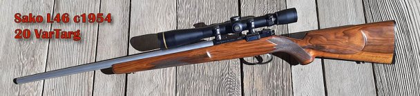

I don't know if the action was bedded, and I would like to take the action out of the stock to just look it over before I shoot it, but I don't know how tight to do the action screws once I put it back together. For same reason, I've not taken my other Sako L46 20 Vartarg out of the stock, as I've developed loads where it is right now, but don't know what that represents on either rifle...

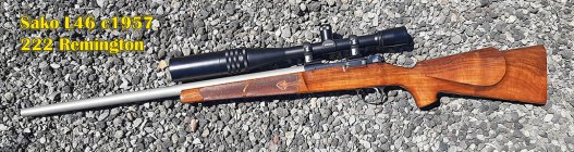

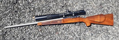

And you laid in on rocks for those pics.....

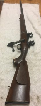

Here am I waffling on about a Sako L56 but with a refresher on the NET realize there's no such thing !
Referring to this L46 site indicates it's of June 55 build.
We got it from a dear now departed friend and he also had a 243 maybe a L461 in similar heavy barrel build that another friend acquired.
Currently ours is without scope, just resting quietly in the safe.
We got it with a trigger shoe as because these don't have an adjustable trigger it bluffs the shooters finger into believing much less force is required to trip the sear which helps immensely with precise shooting. < Highly recommended.
Quite plain walnut so unsure if it was sold with an oiled stock as it is now or the varnish had been sanded back which seems the more likely as the chequering is no longer sharp.
Further details are muzzle diameter 3/4" (19mm) and effective barrel length is 22" (~550mm)
