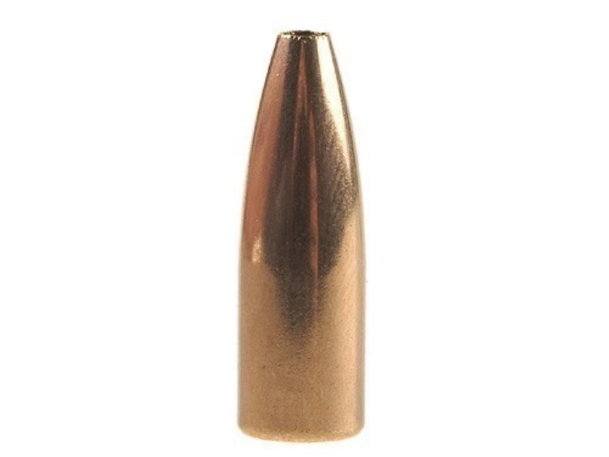

I see Midway has this Speer 4708, 52 gr hollow-point, and reviews say it's good in 222, accurate for targets and also super effective on small game, any experience out there? It's at a good price for .11 per bullet too.
Of course try what you have first and with luck you'll be on the money right from the start.
Like I mentioned before I've had great success with 50gr Hornady SX #2240, flat base soft point.
