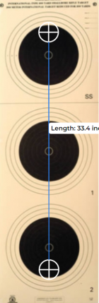

I went to the range to check the vertical movement of the Seb AR250 rest. The Anschutz stock was placed so the rear of my rear bag was 30.75 inches from the front stop of the rest. The rest had a vertical movement of 36.5 inches at 100 yards. This would allow the shooter to hold from the top of the 2 lines on the sighting bull on the NRA A-33 target to the bottom 2 line on the bottom-scoring target. The same ability will apply to the NRA A-51 target used at 50 yards. This will allow the shooter to go back to the sighting bull at any time during the string without adjusting the front or rear bag.
I also tested movement with one of my CF FC rifles. The 284 Win rifle stock was 5.75 inches longer than the 22 LR stock and this reduce the amount of movement down to 27.5 inches which would barely allow movement from the SS bull 10 ring down to the bottom record bull. The rear bag would have to be moved forward, in this case, to shorten the distance and give more vertical movement. FWIW the rest handled the recoil of the 284 Win quite well.

  • Assuming a 29” distance between the center of the rest to the center of the rear bag, the joystick vertical travel on the target paper is approximately 16.8” at 50 yards and 33.4” at 100 yards. Shorter rifle stock will have even more vertical travel. Attached below are the vertical simulation on the NRA A-33 and A-51 papers. The finalized version have even more vertical travel than the prototype Larry tested.
