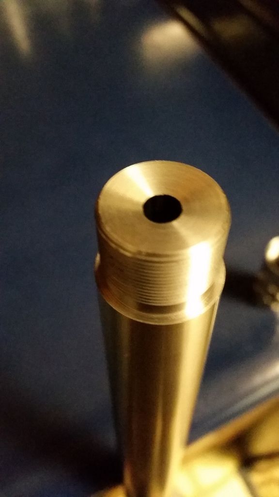

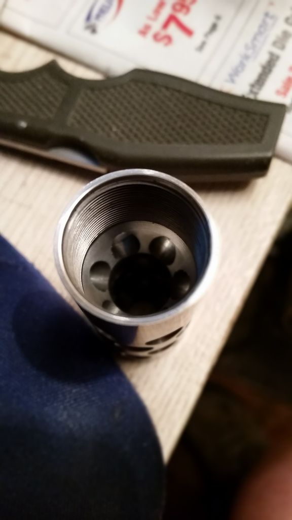

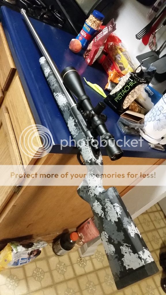

I aquired a Stiller TAC30 single shot, and had a 25 3/4" Bartlein 12 twist 22BR barrel set up for a Remington 700, so I decided to put that barrel in the lathe and fit it to the new Stiller. I had sold my 22BR reamer so I had a new plan. After taking .062" off the tenon, recutting the .705" bolt recess, and bringing the trued 700 tenon diameter down to 1.062", recutting the threads, I got my 22BRDX reamer out, fitted it with proper pilot, and ran it in to fit with 22/6BR headspace gauge with light crush. This chamber max OAL was 1.532" since the BRDX reamer was run in short. I trimmed brass to 1.528" because it will shorten some fire forming. I got this all done yesterday 6/23 so I will be looking forward to fireforming this weekend. The case will be a 22BR-AI with shorter neck than 22BR with a final case length of 1.520". I am hoping for stellar performance on varmints out to 350 yds, and hopefully with the 53 grain V-Max. The barrel has a brake I bought here from john11/87. I did make a modification to his brake and cut a 60 degree angle inside, for more area for the pressure wave to hit. Some shooters here started this and it does make a difference.
11 degree crown

Very nice gun! That is a great looking varminter, I really like the components. Please let us know how the groups are and velocity and what bullet it likes the best.

I've not heard about an 11* crown and a 60* brake, is that supposed to reduce recoil? Could you give some details?
A shooter here came up with the 60* inside combined with the 11 degree crown, I just kept hearing him say how much better it was to reduce recoil. I guess I am kin to folks from Missouri, had to see for myself, you have to know the guy to know my meaning, but it is a better design. I have a brake on a 284 Shehane I did the modification to. Before and after needs to be seen to believe. Easily an extra 15 to 20% reduction.

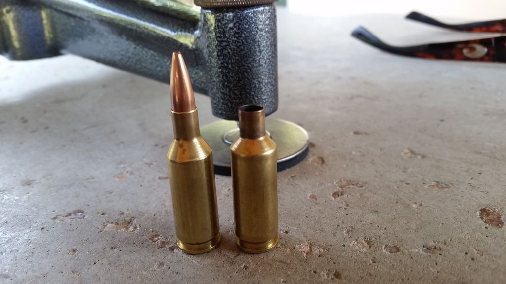

Well braved the heat and got 52 pieces of brass fireformed, nice thing about the AI is no false shouldering just load and shoot. Before and after picture. I had a 12 shot string go into a .596" group. 28.4 H322 and 60 gr Hornady HP -.010" WSR primers.
Going to anneal, sonic clean, size and prime for load work next. I am thinking 3 bullets the 52 A-Max, 53 V-Max and the 50 gr Nosler BT.
