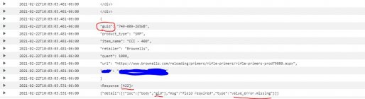

Yep.. I am so sorry guys.
Makes me so ******* mad.
Here is what happened:
At exactly 10:03AM CST we detected the Brownells primer coming in stock.
GID is the unique parameter that our system takes in to identify when the last time a product ping was sent out, so we don't ping the same product every 15 seconds until it goes out of stock.
I typed "GUID" instead of "GID" as the key for the identification parameter.
The system did not see a GID coming from the post request, and did not act on the ping because of it.
In non-technical speak, I misspelling a field that the server needs to identify the ping is legitimate and in-stock. Because of that the server couldn't validate that it was a legitimate ping, and did not act to notify y'all.
I fat fingered the typing f'd this up. I am sorry guys.
Of-course now its all fixed, so frustrating.

Two suggestions, Storm...
1. Set up a temporary web site, emulating one of the retail providers you're scraping, and use that to fully test your code. Depending upon actual web scrapes, from the actual retail vendors, happens far too infrequently given the paucity of product.
2. Reset the monthly invoice clock for all subscribers each time there is a missed ping, until such time there are no more misses. Don't invoice again until every subscriber has gotten a full month of a healthy system.
Hope you get it sorted.
I had actually already begun working on the first.
The second was planned but not executed on yet, both will happen.
