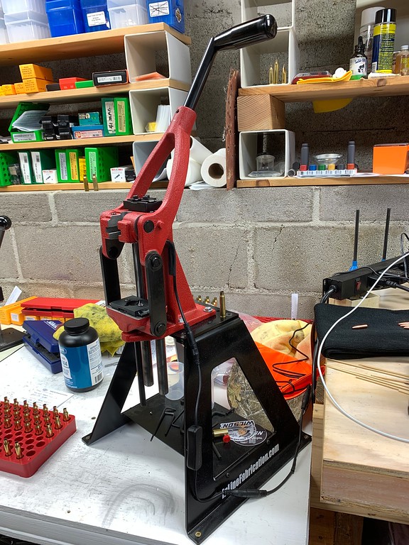

I should have noted in my previous post, that I've made a couple modifications to my COAX that have really improved it's functionality. I built a 9" riser out of 3" steel pipe and 2 floor flanges. It raises the press so it is much easier to see what you are doing and also raises the bottom of the handle stroke to a point where you don't need to bend down each time. As mentioned by rockable in an earlier post, I also built a short handle (4") with a round ball on the end. I really like the reduced stroke with the shorter handle and have not found any job difficult, but I only FL resize and bump the shoulders back on 243, 6.5 CM and 223, no "case forming".

To me, the critical feature of a press is how consistently is sizes brass. In general, bigger heavier presses have less deflection and size more consistently. While my Co-Ax is great, it does have more deflection than my Prazipress. Pulling hard in the Co-Ax handle will size more than light pulling in the handle. I would use this to make sure all my BR cases are within .0005" in shoulder length--assuming I can really measure to a half thousandth with my Mitituyo digital.
I was asked about my Prazipress in a PM and here was part of my response which is applicable to this thread. My percentages are approximate as I didn't keep a log of the actual numbers.
Using the custom Whidden dies in the Co-Ax I would have cases size with the first stoke to within a half thousandth about 60% of the time. Probably 30% of the cases would come out a thousandth too long and maybe 10% would be two thousandths too long. The cases that are too long would need to be sized once or twice more to get them within spec. On rare occasion I would get a case too short by a thousandth--probably self induced by over lubing.
Using the custom Whidden dies in the German Prazipress, I estimate 85-90% of the cases size to within a half thousandth. The others are never more than one thousandth too long. I never get any too short unless I over lube them.
I also find that I get more consistency using RCBS case lube and a lube pad vs using Imperial with my fingers.
