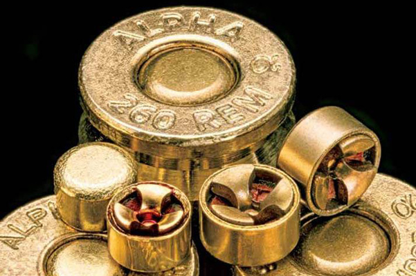

Apparently, Alpha Munitions has done some testing too and why they've gone with a larger flash hole for their SRP's.
Yes, I've noticed that. It seems that Hornady, Starline, Alpha and PPU have for whatever reasons decided to retain 2mm flash-holes in their SRP brass. Lapua and Peterson have adopted the small version with their SRP 'special option' variants. (I'm assuming that the promised Lapua 6GT brass will have 1.5mm flash-holes as with their existing 308 'Palma', 6.5X47L, and Creedmoor SRP cases.)
