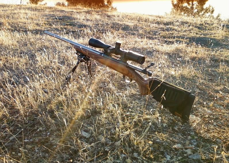

Here's mine:
UglyBastid by Sharps45 2 7/8, on Flickr
You probably won't get many responses as the 'Ole Warhorse' just isn't romantic enough for the younger studs! Me thinks German Salazar and I were cut from the same cloth as we both still shoot a lot of '06 at long range....and it does quite well. German is living proof to it's competitiveness on a national scale! And I did quite well with it when I was still shooting competition. As you can see...I don't care for 'skinny' barrels!
