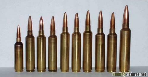

Here is a link to a photo of all of the current "Allen Mags"
http://www.longrangehunting.com/forums/f22/kirby-you-need-website-20165/index3.html
If you go back a couple of pages in this same thread you will find what each of the parrent cases is.
Hope this helps

For those of you that have not seen these magnum chamberings, enjoy.
Allen Mags
224 Allen Magnum
270 WSM case .............. 107 gr ULD RBBT........3400fps
257 Allen Xpress
300 Dakota case ............ 142-156gr ULD RBBT..3300-3100fps
6.5mm Allen Xpress
300 Dakota case ............ 142-165gr ULD RBBT..3350-3100fps
270 Allen Xpress
300 Dakota case ............ 169.5gr ULD RBBT......3200fps
257 Allen Magnum
338 RUM case................ 156gr ULD RBBT........3300fps
6.5mm Allen Magnum
338 RUM case................ 165gr ULD RBBT .......3300fps
270 Allen Magnum
7mm Rum case................ 169.5gr ULD RBBT....3400fps
277 Allen Magnum
338 Lapua case................ 195gr ULD RBBT.......3200fps
7mm Allen Magnum
338 Lapua case................ 200gr ULD RBBT......3250fps
338 Allen Magnum
408 Chey Tac case ........... 300gr ULD or SMK ...3400-3500fps
