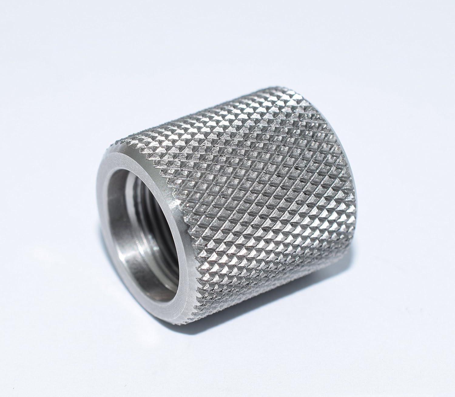

So since I have a .223 with a threaded barrel that means I need one of these right?
Not at all The JP Enterprises break works very well but I never can get used to the size of it myself but a 223 has a very mild recoil most people don’t use a break at all with that caliber
