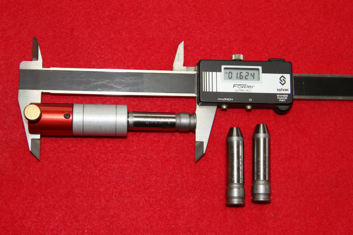

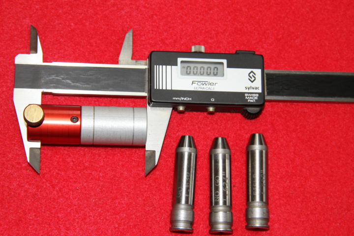

I was working on reloading my first 30-06 as a learning lesson and struggled to say the least. I have watched many video's and read the reloading book from Hornady. I attempted to setup the sizing die so that I created a headspace gap of .003 on a once fired round out of my rifle. I just couldn't budge the head back at all and ended up ruining the die and shell. Well screwed that up for sure! Fortunately they aren't terribly expensive. I spent the evening thinking about what I did wrong and am still a little baffled. My assortment of once fired cases all measure very close if not exactly 2.0450 using the Hornady headspace measuring kit using the .375". The new unfired shells also measure 2.0450. Would a new gun and new shells have such tight tolerances that the cases just didn't stretch at all? After the fact researching I believe the minimum measurement on a 30-06 case from base to datum line is 2.0487. So I am already below the minimum with new shells and the once fired shells. I suppose trying to go even smaller is what killed the whole deal? Wish I had seen notes about that in the 15 some articles and video's I watched about headspace. They all just pretty much say for hunting to go .003 below the spent round case. I'm guessing that didn't work out at all since I am already below the min? Any advice? Do I just use the full sizing die to neck size them? Do I get neck sizing die? Don't want to break another die so any advice would be appreciated.

45 years of reloading with many types of lube, never stuck a case. You need more lube. Don't want to interpret all of your numbers but I reloaded sucessfully for decades without any type of gauge. If you can rechamber a fired case you could reload it without any resizing as long as the neck grips a bullet. I now use the method of adjusting my dies where you do just enough sizing to chamber a round with the firing pin spring removed and closing the bolt the last half way with very little pressure on the bolt handle. The case needs to be fired 2-3 times with ideally just some neck sizing to match the chamber dimensions. Back the die off about a half turn for your beginning try. You want to start not sized enough, screw the die down in small increments and keep adjusting down until the bolt hadle closes the last half way down very little effort. No gauges needed. The chamber is your gauge and not some arbitrary measurement.
PMI makes a great tool for adjusting die to give just the right amount of shoulder bump.
I got a comparable measurement from fired 2 times shells. I want .002 bump back. I start with PMI/die set not to bump and after 4 or 5 times of moving die down half thous I get the bump I want.
Using .002 the rim thickness doesn't hamper length/chambering.
If I bump back too much that one goes to a sighter. I'll get it right next time.
