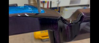

Drill cap 1/4×20 bolt 5-6" washer and nuts to lock it down run 2 nuts down half way and tighten strip remaining threads above nuts. I wrap 3/4" tape to fit into pillars counter sink but not touch stock.View attachment 1613378

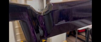

Black pipe tacked into square tubing...View attachment 1613379
You'll need a hand for attaching the feet to hold center of stand on a chunk of 2x4 with a level to keep things plumb, mine are 1x2 scrap 12" long, tack both sides at bottom then fill the gap with wire.
Now before y'all bust my ballz remember I'm a painter 1st, grinder second, a welder I'm not!!View attachment 1613380raising the center gives clearance for washing down the floor and no wobble of stand.
Stand are strong yet light/easy enough to move without removing stock.

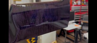

I carried this across the driveway just to see it in the sun as soon as clear was out of dustView attachment 1613381
