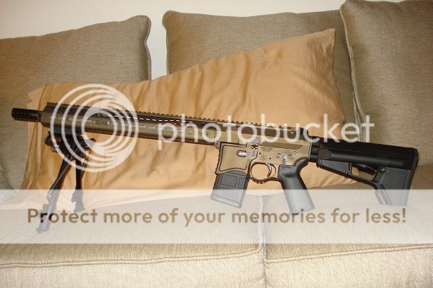

I normally don't post builds that i do but thought what the heck :) This is 1 build i just got back of a couple i am doing. I built it short for the woods, balances out very nice and will be a pleasure to tote around. I have not got optics yet as i am up in the air on what to put on it. I have a buddy that swears by the aimpoint micro-T with the dot at 2moa but i just am not sure if i want to use a 1x power optic or go with something like a 1-6 power.
Dan give us a break down and you used a real quality upper and lower. It looks spectacular to me living in the peoples republic of new York.

The parts i used for the build are:
Seekins billet IRMT-3 upper
Seekins billet lower
Seekins SP3R V3 mod rail 15" in length
Seekins muzzle break
Noveske 16" Recon stainless barrel 7 twist ( these are Pac-Nor blanks )
Geissele SSA-E trigger
PWS buffer tube mil-spec
Spikes tactical ST-T2 heavy buffer with tungsten powder
can't remember the buffer spring i used
Magpul ACS mil-spec stock
Rock River lower parts kit
Fail Zero nickel boron coated bolt carrier

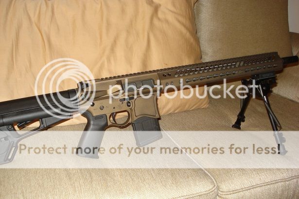

The rifle was cerokoted in a mixture of burnt bronze and HK black. It toned the color down and the pictures with the color of the pillow in the back ground and flash of the camera make it look lighter than it is. Like the color very well as i am not a big fan of the straight color of burnt bronze. The PWS buffer tube is the best out their and has the flush cups that are on each side. It is machined as 1 piece from aluminum. The rail attaches to the upper as the upper is machined only for this rail that i used. You would need their standard upper if you should choose to use different style rails as no other rail will work for it. The upper rail is not that large in circumference and fits my hand very well. The bottom is flat and will shoot nice from a bag or resting on objects in the field.
