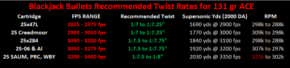

The 25 Creedmoor is now officially a SAAMI spec'd cartridge and they used a 7.5tw test barrel.
One of the things I like about using single point cut barrels like Bartlein or Krieger is with regard to twist they can make you about anything you want versus button rifled you're limited to whatever twist button they have on hand.
I think if I was going to do a 25 Creedmoor I'd go with either a 7.5 or 7.75tw that way you could shoot the even longer and higher BC 135 Berger or the new Hornady 138 A-Tip. I have some of the new 138 A-Tip and they're a wicked looking 25 cal bullet. They look like a ballistic missile just sitting in the box.
