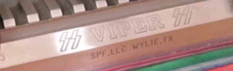

I dont like nazi symbology.
If it frightens you, the Kelbly Golden Bear is very similar without scary letters. Kelbly will provide it in the default gold finish, black nitride or, if requested, plain stainless.
BTW, using proper punctuation would make you appear slightly less ignorant.
