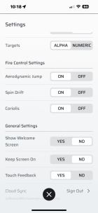

How do you turn on spin drift and coriolis?

Interesting. I assumed everyone had it but now that you say that I just looked and mine shows I paid for something somewhere so Imma an Elite level user and I have no recollection of subscribing to it before o_O I must have paid for it at one time and forgot. I use Shooter for the most part because it's super simple and works well in the field. For a hunting rifle in the field I turn all of that off.

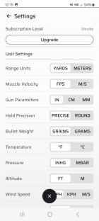

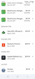

Hi Doc,
It says I'm ultralight, see attached. I only bought the app back in the day, but never upgraded it. I do remember being able to use spin and coriolis.....can't say that I recall aerodynamic jump on my old one though.
The only thing I can find under subscriptions is my on x stuff, so I'm positive I never subscribed to anything beyond the 29.99 purchase.
Thanks, Tom
Hi Doc,
Thanks, Tom
Send this through the in app support button, along with these two screenshots so we can look into why it didn't grandfather this one.
