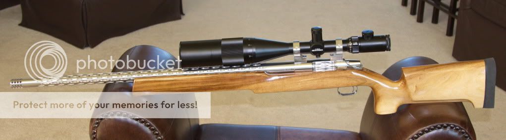

Received my new 22BRX from Tommy Shurley ( http://www.shurleybrothers.com/ ) yesterday. What an awesome job Tommy did. Don't know how it shoots yet but from the looks and feel it is great. Chambered a dummy round and it was nice and tight. Hope to make it to the range real soon and see how good it shoots.

[font=]Nightforce BR 8-32x56 scope w/NP-2DD reticle [/font]
[font=]BAT SV action RB/LP/RE, sp fl bolt, 1.35 round [/font]
[font=]BAT SS one piece rings/base set [/font]
[font=]BAT brushed Aluminum trigger guard [/font]
[font=]BRUX SS 28” barrel w/interrupted fluting [/font]
[font=]Vais muzzle brake [/font]
[font=]Jewell BR trigger @ 1.5oz. [/font]
[font=]PT&G reamer .224, .251nk., .060FB, .218 pilot [/font]
[font=]Figured Myrtlewood blank from NW timber [/font]
[font=]Lowrider Stock carving [/font]
[font=]Hand rubbed oil finish [/font]
[font=]Graco recoil reducer [/font]
[font=]Limbsaver recoil pad [/font]
[font=]Neil Jones custom 3-die set [/font]
[font=]Lapua brass (200 pcs.) [/font]
[font=]Pelican hard[/font][font=] case [/font]
[font=]Gunsmithing fees[/font]
That is an interesting flute job. The rifle looks awesome. Keep us updated how it shoots.
Lucky you went for the muzzle brake, the Graco recoil reducer and the Limbsaver recoil pad, they sure do kick those BRXs ;D

The fluting is the interrupted fluting done by BRUX barrels. The barrel was then polished by Tommy Shurley. I have to say again, I am extremely happy with the results of Tommy's work. When Richard Franklin retired and sold his business to ShurleyBrothers.com I was reluctent at first. Then after much communications I took the leap of faith and did the deal with Tommy. Good choice! Just from my communication with him, and, the finished product, I can say he is a good man. I look forward to my next build with Tommy.
