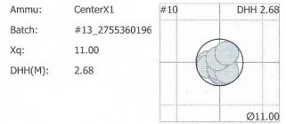

But if you are on a budget an older match 54 such as this example. find a good smith and have a good barrel put on it. I prefer Benchmarks.
Lee
The Precision Woodcrafting bedded stock IMO is the only way to go especially if going the HoleShot arms route. Randy Owens (owner of Precision Woodcrafting) has bedded Turbo actions as well.
Turbo’s win. HoleShot wins. Suhl wins. 10X wins. Someday a Vudoo will win.
it is all about the barrel and ammo. IMHO
PrecisionWoodcrafting is best found on Facebook.
At what distance to target? Very nice group.
I only shoot 50 or 100 yds. the Lapua test group is 50 meters. here is the same rifle with 2-back to back 100yd 5-shot groups. not bad for a rifle produced 55-years ago. goes to prove what I have been saying barrel, chamber and ammo. get all 3 correct and these are the results possible.
Lee
