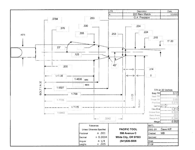

I have a GAP .223 bolt gun with a 26" barrel where the chamber was cut with the reamer in the print below. It has zero freebore (that's right, "zero"). This rifle has been an absolute laser with FGMM77s and I've shot many the 0.25 to 0.30 MOA 5-shot groups with the rifle and that ammo. I have developed a load for it with the 80.5 gr Fullbore that also shoots exceptionally well. As you might imagine, the 80.5 gr bullet is sunk farther down in the case than would be considered optimal, but it still works very well. My point is that with commercial ammo, you will only be able to test a variety of available loads until you hit on one that shoots well. That is the best you can do if you're not rolling your own, and there is always a certain amount of "luck" to finding just the right commercial ammo load. You will have to use that approach, regardless of which chamber you select. So I wouldn't agonize too much over the decision. There are an awful lot of folks that have been very satisfied shooting commercial loads out of a Wylde chamber. The freebore in a Wylde isn't so long as to force the majority of med/heavy bullets in factory loads to jump a country mile. If I had to make the choice myself of the three reamers listed, that is probably where I would go. Given my experience with the chamber cut by the reamer below, my 2nd choice would probably be the one with .040" freebore. Either one should get you where you want to be. The advantage of the .223 Match reamer listed would be largely lost if you aren't going to load your own for quite some time.
