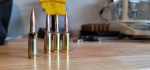

I ended up cutting a window in a piece of brass and seating a bullet so the base of the bullet is right about where the body-shoulder junction is and this puts about .145" of bearing surface in the neck. I loaded up three more dummy rounds to the same length and I think this is what I will have my reamer cut to. It looks like the freebore is going to be around .220".
Any other words of advice, or should i send it?

I have been reading that thread you are referring to, and maybe I am not understanding freebore completely.
I guess my question really is; do my dummy rounds look good? My intention is to send these off to JGS to have a reamer made so I will let them figure out what the freebore really is.
I only shoot two bullet diameters 6mm and 7mm. For both of these diameters I purchased a PTG unithroater. When I purchase a new reamer I generally specify a freebore that is on the short side. With the unithroater I can always add freebore but if your reamer comes with too much freebore and you chamber your barrel with it you can't reduce the freebore. Most of the rifles I shoot shoot best somewhere between .020 jam and .030 jump. The unithroater allows me to get my chosen bullet just about right where I want it sitting in the case neck.
The only thing with a unithroater is that it can cut metal really fast. When you use one I can't overemphasize go very slow, take very little metal at a time and you can get the bullet right where you want it.
The way you have the bullets sitting into the cases looks OK to me. I like to have the boattail bearing surface junction on the bullet just above the neck shoulder junction on the case.
