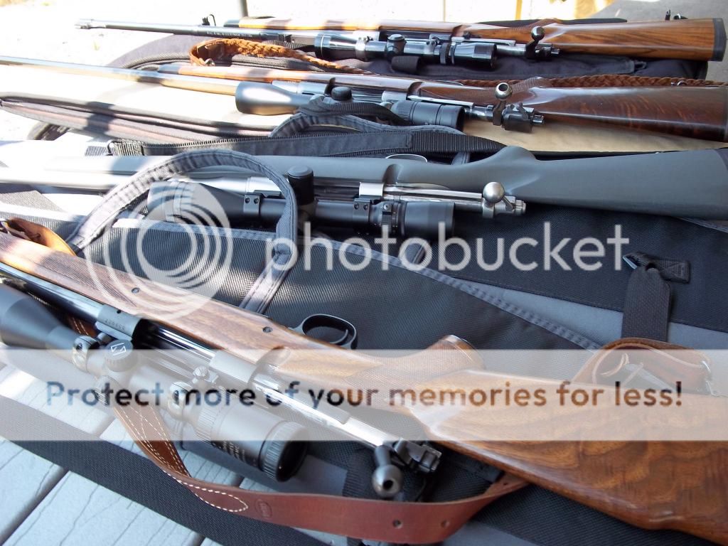

There are other good makes but I am shooting my Kimber 8400 Montana 7mm WSM and 270 WSM well.
The third rifle from the top is my Kimber 270 WSM with a Leupold 4.5-14. The second with the fine stock is my favorite custom with a 3-9 Swaro in 30-06.
And this has exactly what to do with the original question?
Some things never change with you Don.... ::)
