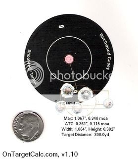

I like it with LC brass @ 2.5" with hBN'd 75 AMAXs.
1/8 Broughton 5C cut by APA.
I've shot that combo out to 1200 yards.
I haven't shot the 69 out of my rifle but 26 grains in my rifle shoots pretty good.
