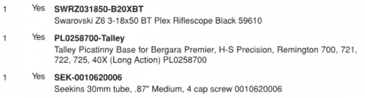

I have the Swarovski Z6 3-18x50 BT Plex rifle scope
Went on Swarovski ballistic chart and imputed the load I'm using.
Zero at 200 yards.
Want to set the turret up for 400, 500 & 600 yds. (Since it only drops 6" from 200 to 300 I don't want to set the turret at 300.)
Per chart attached.
13 clicks for 400 yards
20 more clicks for 500 yards
28 more clicks for 600 yards. (Problem is I run out of clicks?) It stops at 20 so I'm 8 clicks short for 600 yards. Am I doing something wrong?

I had a quick look at the Swaro website - quite unhelpful - but it looks to confirm your problem. In common with many Euro scopes, it doesn't have sufficient elevation. So.. you will need to fit a say, 20 MoA rail. You probably only need a 10 MoA, but best of luck there. Perhaps Burris Signature rings would do the job. I do suggest that you zero a 300 and hold down when necc.
I go with Burris XTR Sig. rings and, usually, a 20MOA base. That enables me to make sure the elevation turret is just a few moa off the bottom when zeroed at 100 yds. You have over 64 moa of adjustment, which is plenty if you mount it correctly, because you probably do not need more than 12-14 moa to get from 100 to 600.
