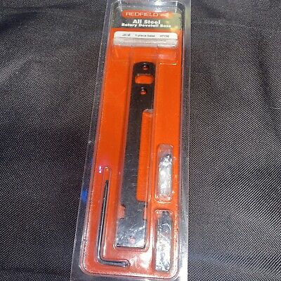

My M38 Husky uses an old Redfield windage adjustable one piece base with Burris rings. I had to add a piece of .015 brass shim under the rear to get average hand loads to hit at normal distances. There has to be plenty of these bases around. Put out a wanted post.
I used a thin mirror and flashlight and saw letters MK stamped under the bridge.
These can still be found on ebay and are compatible with twist in rings from Leupold, Redfield and Burris.
