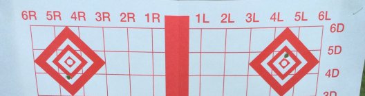

I'm not trying to get the calibration dead nuts on, just trying to understand a few oddities that I have noticed. Setting up and shooting a couple of new systems I am putting together for my club I noticed that in a string of 5 shots, 1 shot, left outer most, will appear farther left on the X axis than the actual hit while the shot which is right outer most will appear farther right than the actual hit. The ShotMarker "picture" shows the group to be a wider group than the actual group on paper. I guess there is no way to correct this as I can only move the whole group right or left by inputting negative or positive amounts of millimeters on the X axis calibration. Is there anything to gain or lose by just shooting 1 calibration shot and using it to calibrate the target?

…I noticed that in a string of 5 shots, 1 shot, left outer most, will appear farther left on the X axis than the actual hit while the shot which is right outer most will appear farther right than the actual hit.

Since left side shots need to be further left and right side shots need to be further right, I think your basic dimensions in the horizontal direction are incorrect. In other words, ShotMarker thinks you have a different size target than it really is. I suggest you re-measure your microphone spacing.
Offset is just that; it moves the impacts as a group on the screen. Your impacts in the target are shifted from the electronic image. We run 14 ShotMarkers at the club and each of them has an offset dialed in. The reason is that continued X's and 10's actually hit the paper target low. That preserves the visual aiming point by putting the impacts lower than the X.
When measuring your sensor spacing, I would use a metric tape and remember to measure from left edge to left edge of the brackets for your width. Top edge to top edge for your height, and corner to corner for squareness of the sensors. You want to be within a couple of millimeters between each pair of sensors.

You are using the term calibrate incorrectly. You do not calibrate single data points, from any measurement system, you calibrate a system. When you calibrate the ShotMarker system you are shifting the system data output to get the best match with what you see on paper. The more shots you shoot and the more iterations of shifts, the closer the match. But usually three to five shots and one or two shifts is good enough.

I don’t think it’s as simple as a shift of a pattern (X,Y), or a scale issue (zoom in/out so to speak, fooling it into thinking the frame is a different size) it is a different pattern all together, not just in the incorrect location.
This.
Shows up on screen as this.
