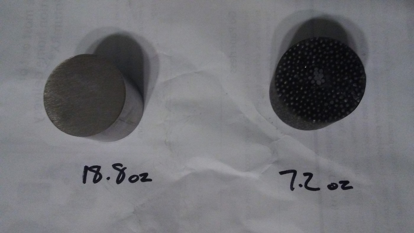

FWIW- tungsten weighs a lot more than lead shot. I bought some used Mallory Metal slugs off eBay and made a plaster mold of one. I poured lead shot and epoxy in it. The lead and epoxy copy weighs 7.2 oz. The tungsten weighs 18.8 oz.
