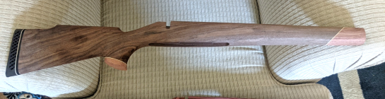

So, I've been wanting to try doing this myself for a while and I'm finally going to tackle it. The stock is rough shaped, lots of tool marks and such. Inletting should be close, I'm sure I'll have to finish that a touch or two.
I've read a LOT online and here on steps and how to get to the actual finishing stage. One of my many questions will be what finish? I have TruOil, Arrow, Gloss Wipe-On Poly. But open to getting what I need to do it right. I'm leaning towards a glossier finish. But I realize I'm a long way off from this stage.
Guess my first steps will be to start sanding. 120 or 220 grit to get to the shape I want it? Being careful not to create ridges and go with the grain as much as possible. Any other tips at this stage?
Here is the before picture of my stock. Wood is walnut with rosewood (?) grip cap and tip.

Looks awesome... sort of the shape I'm after. With a little rollover on the opposite side in the cheekpiece.
Looks like a Richards microfit! Sometimes these get a bad rap, but I love them.
I usually start at 80 grit and take down some of the deeper tool marks. Go up to 120-180 from there. After I am happy with this, I make sure my inletting is good and my barrel channel is where I want it. Pretty much every time I have worked with one of these the bolt handle wasn’t moving freely so make sure you’re happy with that. Then I proceed with a pillar and epoxy bed and finish sand at the end.

you are correct, it's a richards microfit. that's a good plan of attack on order of doing them.

that's a clean lookin rifle, good looking
