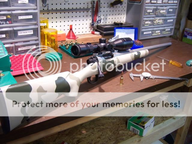

I have a stiller predator action, with a shilen 10 twist varmint contour barrel in 6br, and it feeds flawless. I had my smith shorten the mag follower and insert a spacer inside the box magazine to shorten it up a bit to match the follower. My rifle is great! My stiller is a rem 700 copy so you shouldnt have any trouble. Actually I started out with a rem 700 before i went to the stiller. the reason i switch was simply because i like custom actions. they just make since to me. The stiller predator action is only around $200 more than a trued up rem, and you get a better extractor with the stiller. The only mechanical complaint i had with my rem 700 6br was the ejector. it worked ok stock, but the stiller pitches the cases out even better. Maybe to good. I think i will snip off a couple coils on the ejector spring. Do it, but do it correctly and you will be fine. I never had any feed issues or scratched cases!! Lee
