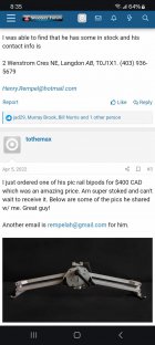

Hello, Rempel bipods are not availlable on EU, no info about seller on EU...

I've email ed with Mr. Rempel, that are very gentlemen, but not have distribution on EU and the final price, duty and import tax included, are very expensive and for me is more convenient buy some other brands for similar type of bipods.
