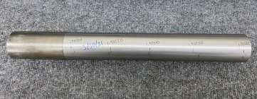

2 inch mild steel test bar sticking out far enough to make me nervous unsupported.

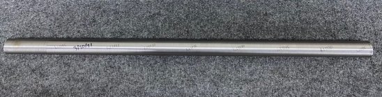

Once I got that cutting without a repeatable taper on <5 thou finish cuts. I borrowed Bamban's blake (which is an awesome tool) to get the tailstock dialed in near the chuck. Then I slid that sucker out 24 inches and cut another test bar totally unsupported in the middle aside from chuck and tail stock. Just took super light cuts .003 at the end to minimize deflection.
I didn't just do the ends/collars like a lot of guys do because I wanted to see how much deflection/push off a 1.25 inch rod would have in the middle and its defnitely measurable. The ends are 3 tenths off from eachother at 24 inches and being that long, I couldn't get a repeatable cut that measured inside that to even try and tweak it further.
