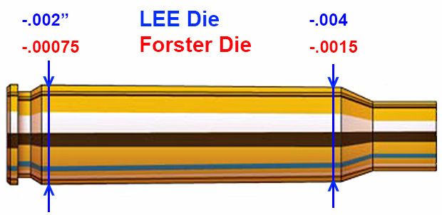

You can't really draw general conclusions about all dies based on 2 dies. Try measuring 100 FL dies including 4 or 5 of the same brand. There is usually about .002 difference in dies from the same manufacturer.
The dimensions of the Forster dies do not vary much from RCBS dies or Redding dies and in some cases the Forster dies are tighter.
The same goes for the head to shoulder dimensions. I have measured many RCBS dies and they seem to target half way between the go and no go gage lengths for their dies.
I am not a fan of Lee dies but those I have measured usually are very close to the major quality brands. However I have a Lee FL in 7.65 Mauser that is .010 too long in the body so it will not properly size a case. The Lee dies for the 7.5X54 French MAS are about .006 to .008 too small in the body causing the case length to grow rapidly from the excessive expansion and sizing.
