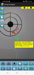

I'm using N555 in my 6.5 creedmoor and I've gotten a load that gives me an avg speed of 2668 fps and a SD of 8.9 fps and a 0.6 moa 5 group at a 100m.

Between N555 and H4350, your friends would have a hard time claiming one is vey much better than the other.
Nothing is cheap or easy to find these days. N555 is a modern powder that is well suited to your application. I don't know a compelling reason in terms of performance since N555 is also temp stable.
If you already have it, and a load that is working, that counts for more these days. You would end up spending more rounds to make the change, to end up in essentially the same place.

Stay with the 555, it's a good powder and from what i have learned, here in the cold north, it is very tolerant for temperature changes.
It wasn't a winner in my old ( and rather short ) .260 rem barrel, but the LW i'm running now, are showing promising groups and velocities.
I am in the process of making the final load for the new barrel and the 555 looks like a worthy contender for the job.
