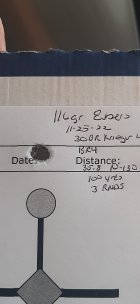

I'm in the same camp...switched to N 130 and I'm not going back to H4198 even if it's available....I made a long drop tube and shoot close to 36.0 grains and it hammers in several barrels I've tried it in.
