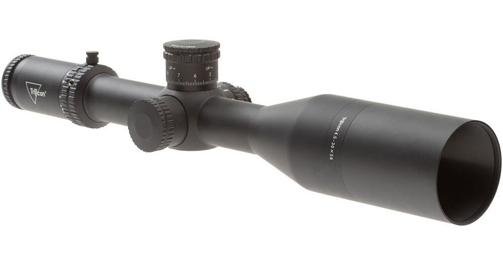

Another 'twist'--the Zeiss scope looked fabulous optically, but it has only 30MOA gross change in elevation, which wasn't enough to overcome, for short-range siting and group evaluations, my 20MOA scoperail ; I actually reversed the direction of my scope rail at the range! ;) I decided last nite that I 'need' one with a much broader gross elevation change and a larger objective lens (and tube) for larger exit pupil, so ordered a
Trijicon 4.5-30x56 Tenmile SFP Riflescope (MOA Long-Range Reticle)​

1. The Trijicon Tenmile 4.5-30 scope performs excellently; it has PLENTY of elevation adjustment so that I can shoot my 20MOA-rail-equipped rifle at short distances.. It's optically excellent, and the elevation, windage, and distance focus/parallax adjustment indications seem to be dead-on; so far, it's the best scope I've ever owned.. (The Zeiss V6 5-30 will be happily used on my Uintah UP-15 6ARC rifle; it too is an excellent scope but with only 30MOA of elevation change.) FWIW, I'm using the Zeiss low 34mm rings...
...with the Trijicon, and the scope is plenty high enough.

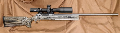

Gave up on the precision-rifle-chassis aspect of long-range shooting and have reverted to my no-longer-safequeen Savage 12 BR rifle..
This is 2017's 12 BR stock, action, and scope rail now wearing the 110's 28" Criterion 6XC-chambered barrel and Trijicon Tenmile 4.5-30X45X34 scope.
This action is single-shot, dual-port.
Will let you know Tuesday how we're doing.
One thing I know--it's at least a pound lighter than the 110.
