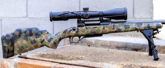

Painted the stock in my feeble version of camouflage, and overall I like it...
...but only AFTER I got the matte clearcoat on it did I realize it needed more brown.. Maybe tomorrow.

BTW the paint shot very well. :cool:

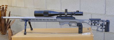

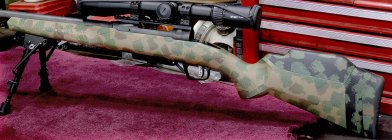

The new 110 Elite Precision arrived today.. Got it cleaned, examined, scope and bipod mounted, etc., and will get it to Usery Pass range tomorrow for site-in and barrel-break-in.
I've tossed those POS-Chinese cheapie bipod legs, which collapsed several times, and have replaced them with a Warne Arca-Swiss-rail type; that works excellently.
