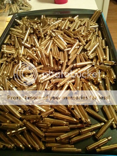

I am doing 500 LC 223 cases at one time with 10 lbs of pins. The tumbler is approximately 3/4 the way full.
The average top loading washing machine has a load capacity of 12 to 16 pounds but how many people actually weigh their loads?
How many people are actually weighing their brass before tumbling, or even have an accurate scale to weigh their brass.
How many people have the same type tumbler, if you do a Google search more people are buying their tumblers from Harbor Freight to save money.
Stainless steel pins are made by many manufactures, come in different diameters, lengths and the pin tips come in varying abrasive qualities.
City water, well water, hard water, soft water all types of water and minerals are being used.
My wife just picked up some more Dawn dish washing liquid BUT its Dawn Ultra with 2X the cleaning and I was using a generic soap before.
The variables in tumbling brass cartridge cases is endless and all that matters is if your brass is getting clean. We are using rock tumblers to clean and polish brass cartridge cases and each tumbler is a science project of its own.

I use approximately two liters of water for 500 cases with 10 lbs of pins...
Try cleaning 100 223 cases with 10 lbs of pins... Wow... man do they clean FAST...
250 cases by weight.
250 cases in the tumler with 10 pounds of pins.
My one mod to the Thumbler. I added stick on grip tape to the rim so it doesn't slip when it gets soapy.
45 minutes.
100 cases. 45 minutes.

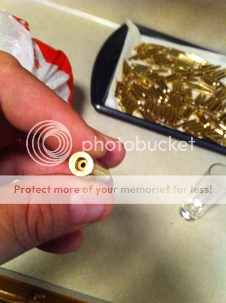

FYI, for those that have the SS pins already, be aware of this fact, depending on where you bought your pins from, there are at least 4 different sizes (diameters) that run from .033", .041", .062" and 0.125" in diameters and from .255" to .500" in length, that I have found.
I know from my tests, the .033" pins I have will stick 2 pins in SOME case primer holes, 9mm/38 Splc calibers, that I know of.
I plan on getting 5#'s more, of a different size and add to the mix etc.

Nvreloader said:
Guys,
Tia,
Don
These odd size pins aren't a problem, I just seat magnum primers in these cases and blast them out while wing shooting mosquitoes in the back yard. These odd size pins are reusable, I just use a strong magnet to pull them out of my neighbors vinyl siding and reload "oops" I mean re-tumble them ::)
