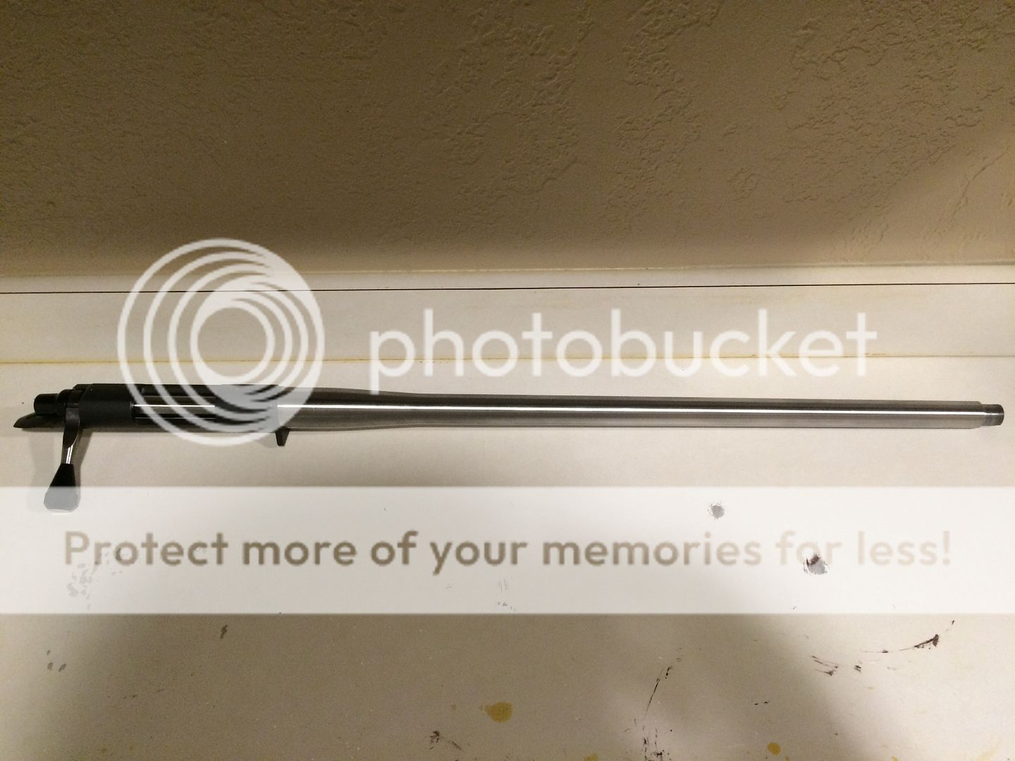

My next 6.5 build?

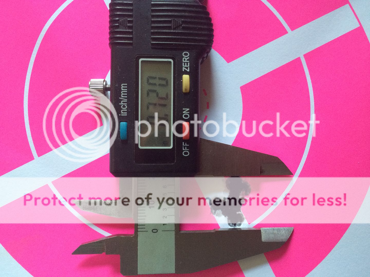

I wanted to give an updated photo of the rifle and groups. And yes the muzzle break isn't timed yet. The groups are 5 shots at 100. I am getting better at shooting it so I think next time I can get better groups. Load is 139 scenar, 45 grs H4350 lapua brass. My next plans are to install a new muzzle break, have the barrel fluted and the gun cerakoted.
